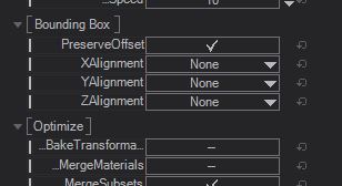

Hey aTom,
maybe the "Bounding Box" properties may help you with that issue.
You can switch the X,Y,Z alignement to "Center" which should shift the Pivot to the center of the Imported Geometry.
This should affect only the first axis (most times called SCALE)..
If you couldnt solve it by that option, please let me know and we will try to fix that.

Hi Dennis,
yes i know this feature when you import the geometrie but i need it later :)
Its a lot of work to export and import new centered geometrie later into a project when everything is adjusted and you found out you have to rotate something around the center of an object.
The center feature would help and will save a lot of time. Also when you create a node in Ventuz and put some axis nodes infront.
Then you have to move the center by hand into the midle or on axis what sometimes really sucks :) A set pivot to center function inside of Ventuz will be a real time saver.
