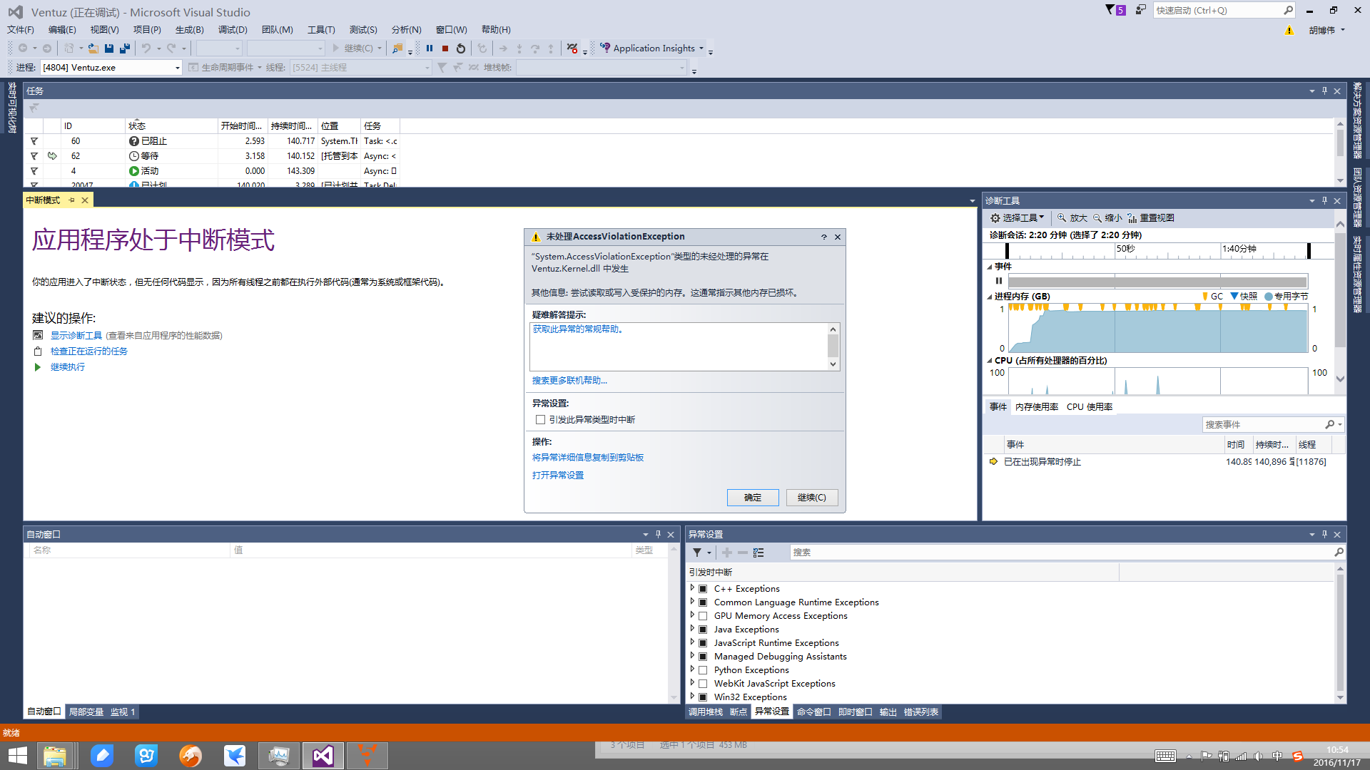

Hi,I encounter a bug when i use ventuz 5 that result designer or runtime crash,and i think the root cause is the Ventuz.pure.dll
1)this is my VZA
ControlUI4.vza
(189.43 KiB) Downloaded 522 times
i creat it use Chinese language,there are some screenshot on error message.
2).
when designer crash,i debug it use VS2015,get this message.
and this is the error message in Windows Event Viewer

3).My work PC is a Alienware notebook,its version is alienware 15
my pc system is Windows 8.1 Simplified Chinese professional edition.
CPU : Intel(R) Core(TM)i7-4720HQ CPU @2.60GHz
RAM:16GB
System Type:64 - bit operating system.
I don't know are these message enough,if you have some other questions ,please contrct me or reply this topic.

Post by Karol » 18 Nov 2016, 11:26
Thanks!
We can reproduce the problem and will fix it!
