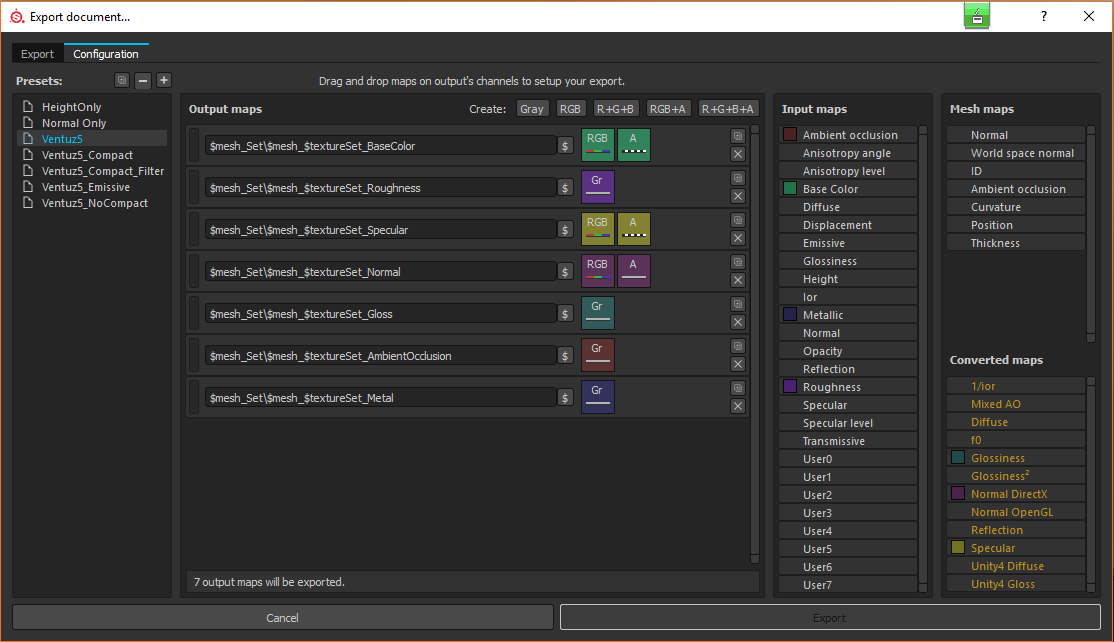

Ventuz5:
This is the basic Export Preset for Ventuz5. It will simply create all available maps, a single texture for each channel. This can be used in combination with the "TextureSet" import with V5.
You can combine and compact them on your own and also modify them easy.
Sidenote: You can export to any kind of supported format.. tga.. png... jpg and so on.

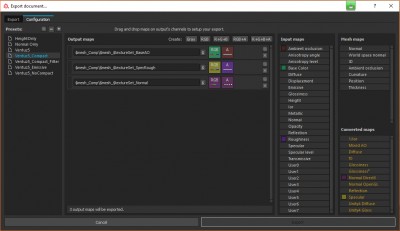

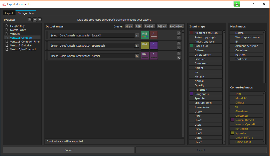

Ventuz5_Compact:
This preset will create "compact" textures. This means you have to manually map the channels inside of the material node. For example:
The "BaseAO" will have the BaseColor in the RGB channel while the AO is inside the Alpha. If you import that texture in Ventuz you should map the Alpha->BaseColor, Multiply.
The compact textures will save a LOT of your materialstages and do not waste the alphas. very handy .. not? :) 8-)

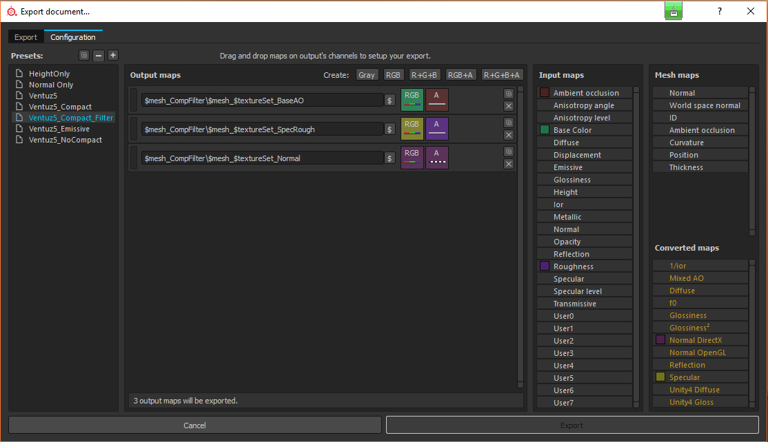

Ventuz5_Compact_Filter:
This is a special set, basically its the same as the "Ventuz5_Compact" but has and can be used with a "baking light filter" .. watch this:

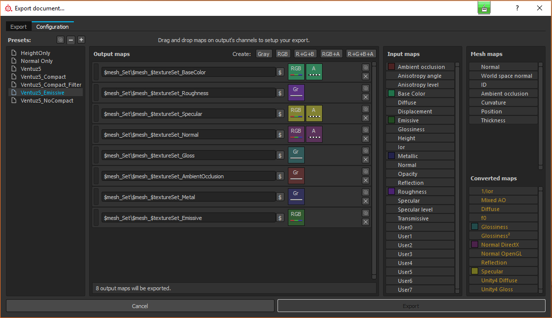

Ventuz5_emissive:
This preset exports single maps, including the emissive channel.
