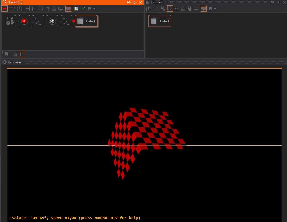

I don't get it. In the attached example I can put the render point on any node, the result is always the same. The good thing about the render point was, that you could easily check out your result at any stage - so in this case without the texture or without the color. Am I doing it wrong?!

Hey Rou,
its correct.
In this case the Material and Lighting will be applied as well.
its more or less like the position of the selected object will be put in the center, you can rotate the object or the environment around.
The idea is to have the object seperated from the rest of the scene .. but still keep the lightingconditions.
It should be possible to "deactivate" the materialstage if you want to have it "pure".
regArts
