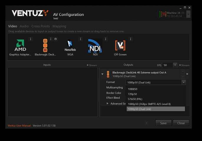

I am trying to get ventuz to output at 4k on a DeckLink 4K Extreme card.
Has anybody tried this yet? I can only seem to be able to select up to 1080 on the Configuration Editor.
Any tips??

4K SDI needs an additional License Option.

Ok thanks, I couldn't find documentation to that anywhere! I will have to ask Sales about prices.
