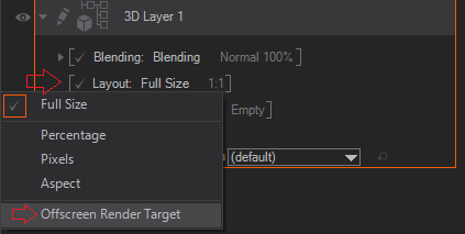

You can switch any layer to become an "Offscreen Render Target".
Simply click the "Layout" in the 3D Layer
then choose "Offscreen Render Target" instead of "Full Size"

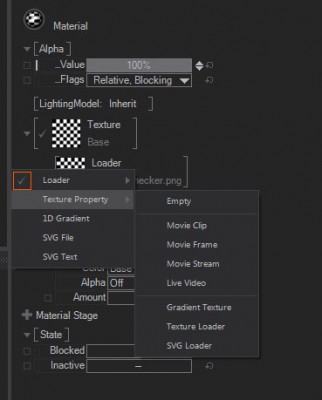

I was assuming it was in the Material node as per the documentation, but I don't see where to link to the Offscreen Layer...
lerou
Posts: 345
Joined: 06 Sep 2013, 07:14
Location: Hamburg, Germany
Re: Using layer as mask
Post by lerou » 12 Dec 2016, 11:33
Unfortunately this is far from intuitive! But you're on the right path. Set it to Texture Property Empty. Now you've got a texture slot. Expose it. On Layer level bind the exposed texture property to the render target's texture property.
