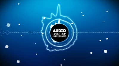

Hey Eric,
Thanks for the response, i wanted to achieve something like the example below.
mainly be able to create like an audio circle reactor.
Thank you.

oh! That is easy - simply make a straight line chart that stretches across the whole screen in X, then apply the polar distortion effect on the layer. That is how you do it in after effects, too.
here is an example, make sure you have an audio input set up in your configuration.
polarcoordinates.vza
(14.19 KiB) Downloaded 443 times

Wow!!! thanks a lot, It works like a charm. much appreciated it.
