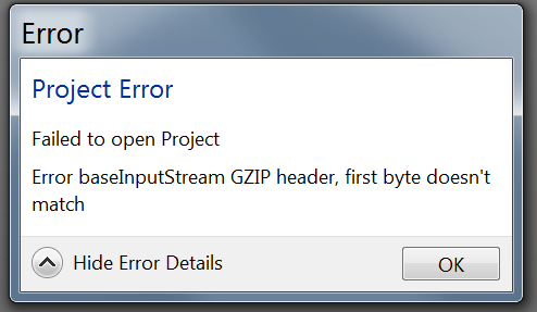

I Think we've opened and saved a Ventuz 3 Project (.vzp) in Venuz 4 as opening it in V3 gives me the attached errormsg.
V3 Presenter says it's not a Ventuz Project file, however it can be opened in V4.
The problem is I need to have it in V3 since it's full of shaders that are not compatible with V4....
Can anyone confirm the cause of the attached errormsg?
And.... if so, is there a way to fix the header so that the Project is able to be opened in V3?

There should be a .bak file of the VZP aside the upgraded one!

Ahh... let's see if I can find it and use it!
