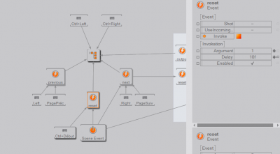

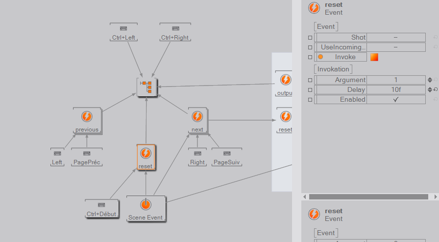

Hi guys,
I think we've got a bug on the slide manager:
I want to reset a slide manager on scene load
so i create a scene event object and link it to reset action from slidemanager
but when loading scene, reset occurs on the slide manger (00 slide activated with red dot)
but Current output from slidemanager stays at saved at the slide that the project were saved
It occurs when on Runtime and loading in the designer
Tried to have a delay of 10f on the load scene event but still the same
Bug?
Florian
