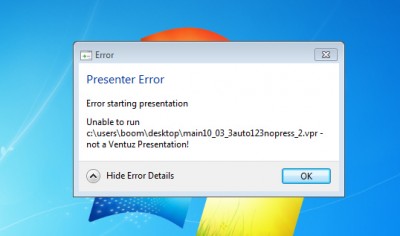

I can not open presenter.
Hi
I export my project to presentation but when I try to open I get this message.
I am pretty sure I used Ventuz4 export to presentation.
Thank you.
Thank you.

Re: I can not open presenter.
What size is the vpr file?
I used latest version ventuzV4.06.01.
file size 3.19G
3.9 GB is definitely to large!
Unfortunately Ventuz 4 only supports VPRs up to 2 GB!
You would need to run your presentation in Director mode (starting the VZP) or you have to remove some large resources from the VPR and reference them via absolute or relative path.
