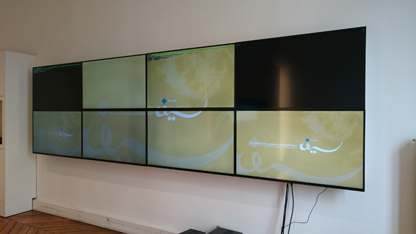

I tried again on my configuration, a "simple" one at the office for showroom purpose
here a movie to download : Video 1.wmv (177.1 Mo) http://f.laboiteaslides.fr/51213/
you can notice a desync from 0:38
after i try to load some movies in another movie node (async on)
Is there someting i'm doing wrong ?
Devices : 2 vbox with firepro w5000
Output for each : dp1 to 3DP hub to 3 screens, dp2 to 1 screen
Screens are 1920x1080px
Simple Ventuz Render setup to take care of screen bezel
4 screen on the left are on 3.01, 4 on the right are on 3.02

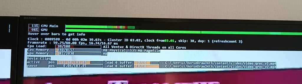

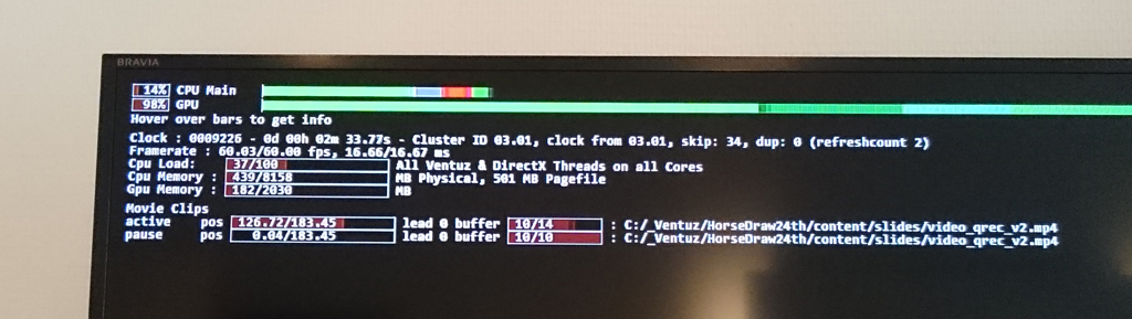

Network : Netgear Prosafe Gigabit router
Sometimes master or slave make some stall on simple movie playback
Some stalls appear when :
- no action are submit (just ongoing playback)
- movie node is preloading (async on)
What i notice :
- when slave skip frame(s) during playback, it don't try to go back to sync
- when preload another movie node, it may stall (not accurate)
- on slave : clock from something switch form 3.01 to 3.02 very quickly (let 10 times then ok)
Notes:
1. delay can't be due tu DP hub because the delay is the same on 4 screens
2. vbox configuration is clean, ventuz to 4.06.01.31, running as vpr
Florian
