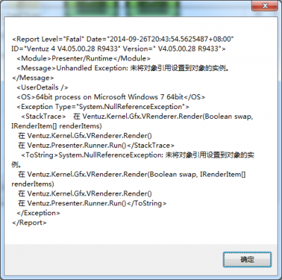

I create a new project, and then create a new layout. But when I export it to vpr, it always crash if I select the layout. But if there's no layout , it just open correct.
The crash information is like this.

Hi Drac Zhang!
With 'layout' do you mean a Layout Scene? What are the exact steps for a reproduce?
Could you send the Error Report if it happens again or post the whole call-stack?

Hi Karol,
I use another two machine test it and all these happened the same thing.
And this is error message the Chinese sentence means "Object reference not set t oan instance of an object"
I upload the test.vpa also.
If export with Stage Edit - Select Current layout - 1080P, the vpr will crash. But if the layout is Default, the vpr is all correct.

Re: Layout crash
Thanks!
We can confirm this Bug. Will be fixed with 4.5.1 which will be released soon.
