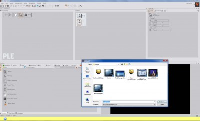

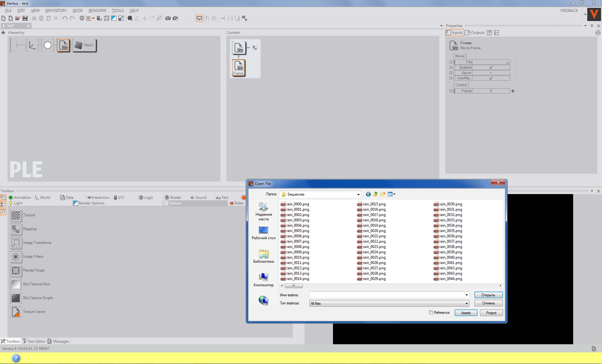

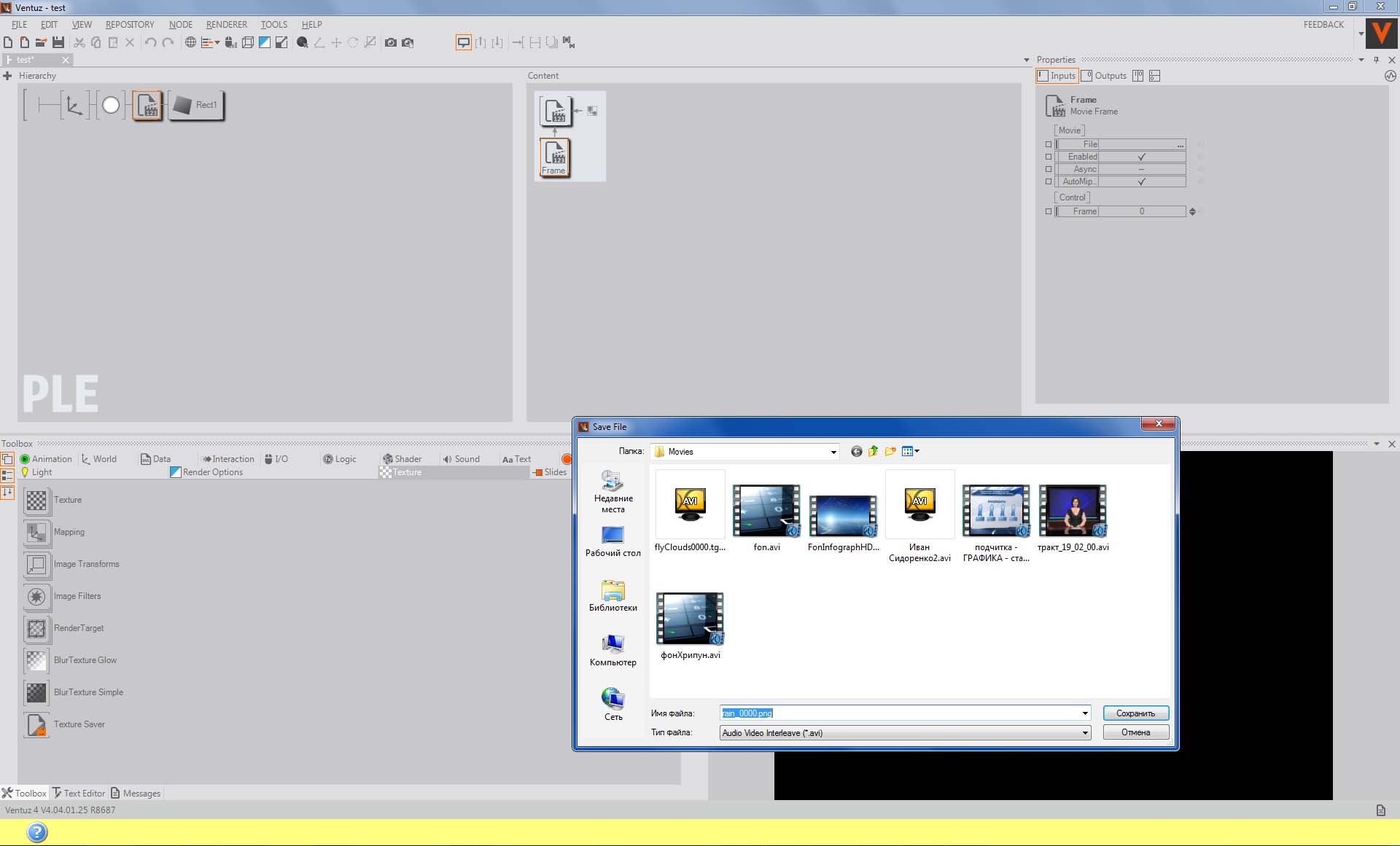

I have a some problem to use a image sequence. When I open a first frame of sequence in Movie frame node, next pop up window is "Save File". It must be so?

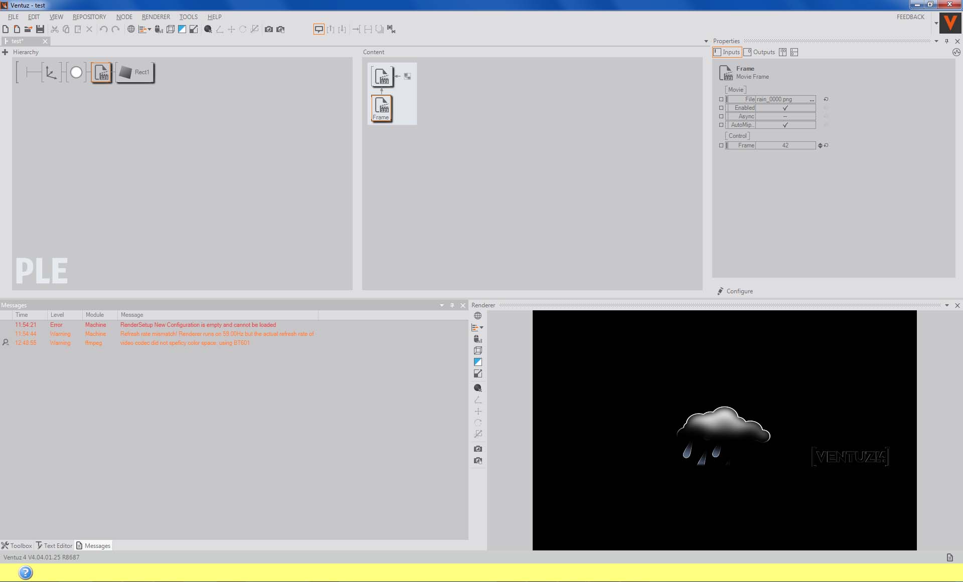

After that a first frame is show up, but a "Frame" parameter don`t changed frames of a sequence.

Unfortunatly our resource import mecanism is not able to import a sequence into the project DataPools, yet. You can either copy the whole sequence to the Movies DataPool manual or check the reference checkbox in the Import Dialog to reference the sequence with an absolute path. Take care that resources that are referenced absolute are not exported within a VPR file and may not run on other systems.
