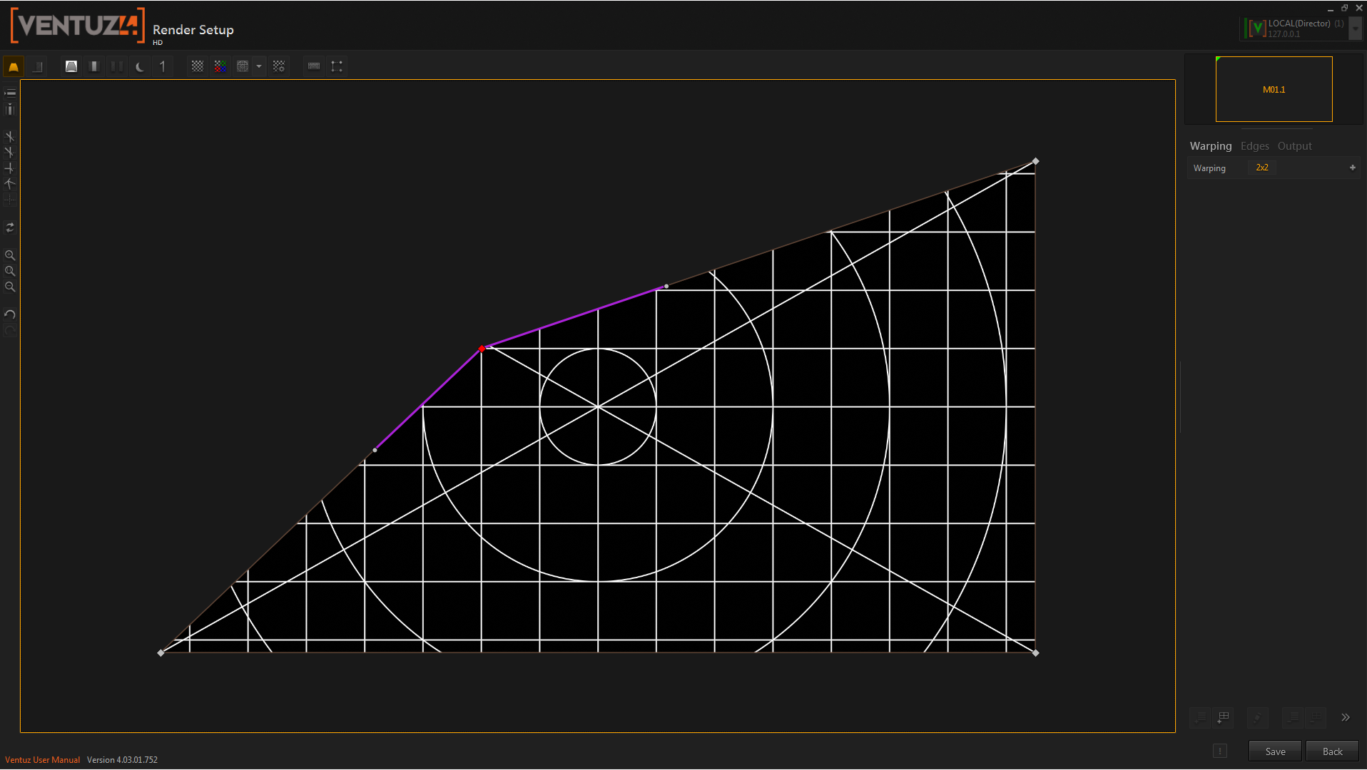

Hello,
When I move a point without warping from an inner position the shaping is moving.

Re: Moving without warping back bug
will be fixed in Ventuz 4.03.02.
The problem that was fixed occurs when using "move without warping" to move an edge point outwards.
Please note that the method we are using for the "move without warping" feature gets more imprecise the more "warped" the image is around the moving point.
But that is not the case here, nothing is warped at all, this should have worked. And now it does![Smile :-)](./images/smilies/icon_e_smile.gif)
1) well you can have multiple layers already, but yes, we are looking at making a bit more functionality to give you some more mapping toolsRobert wrote:Nice !
Btw, multiple warping layer would be usefull.
Display the name of the output on screen would be nice too.
Grab the current render output as a picture pattern would be usefull.
R
2) I thought this was possible... need to doublecheck
3) this is possible... just switch off the test pattern, then you have the live render output? Or am I misunderstanding...?
