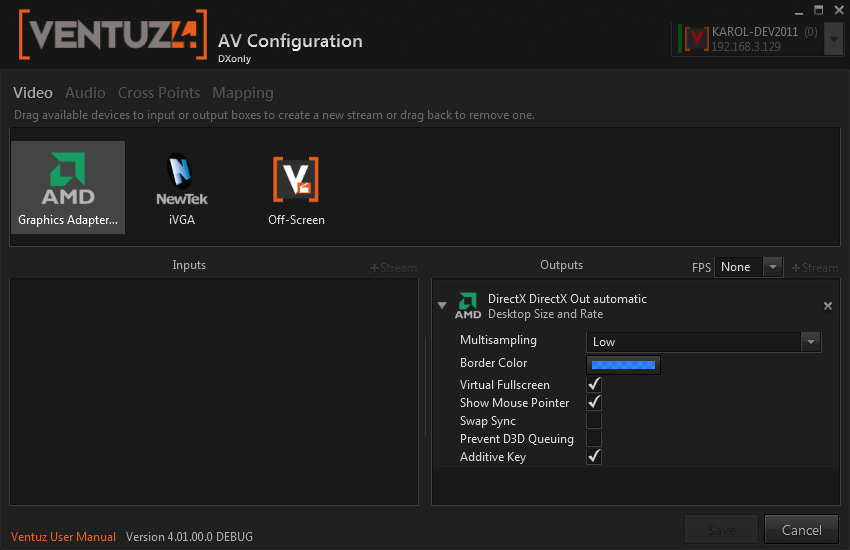

It's in the AV category of the Ventuz Configuration Editor:

Changing the configuration as Karol showed you requires a restart of the renderer to apply the changes. To switch the mouse pointer on and off on-the-fly you can go to the Live Options on top of the Configuration Editor.
