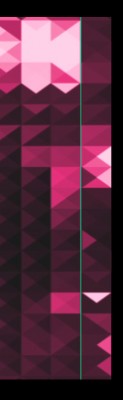

I have found a problem with the movie nodes where a thin green line is visible to the right if I use the 2d Mapping to move the texture in X. If I have the UVW set to wrapping, I cant get an invisible tile as this green line is very visible. The video was exported out of After Effects.
I have enclosed one frame of the movie file so you can test it as well as a screen grab.

It seems to be a probleme in the movieclip if I open the clip in Quicktime there is also a green line.
- QT_Test.PNG (18.99 KiB) Viewed 6173 times
Re: Movie giving green pixels to Right
In Windows Media Player as well!

We have tried Quicktime, Windows Media Player and ffplay, and they show the same result, so this problem is not specific to Ventuz.
The video has a width of 1906 pixel, and is encoded with h264. H264 usually uses a block size of 8x8, so I suggest you try re-encoding the video with a width dividable by 8, like 1920 or 1912 pixel.
