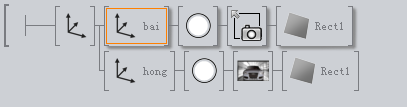

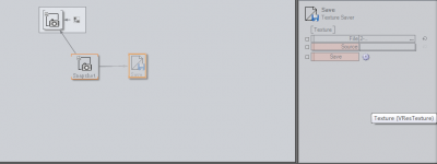

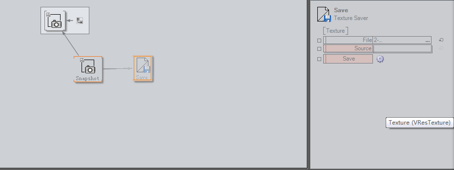

How to intercept the render window in Ventuz a particular area of image, and save to the specified path? I use "Snapshot" and "Save" the two nodes to cooperate, can achieve full screen image and Save to the specified path, but not clipping region of the image I want. E-mail: 448505953 @qq.com for help, thank you!

Insert another Render Target in between both Nodes. Snapshot takes the original screenshot. Display that in another Render Target on a Rectangle for example. Scale and Move the Rectangle around until you have the area you want. This way you can also change the area any time you want. This Render Target you connect as a source to the Texture Saver node.

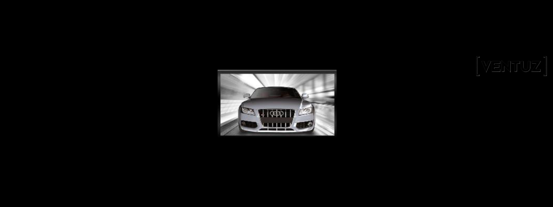

Thank you for your letter! I need: interception car images that an area, and save: every interception is covering the last capture the saved images (image stored in a computer somewhere). Want to finish this task? I know the snapshot can capture, or to edit in c #? It's convenient for (c # I don't understand) can screenshots to me? Thank you very much!
