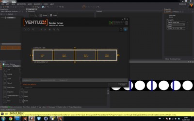

Was playing around with the Render Setup. Configured a single machine with 4 x 1920 1080 outputs.
I love the way that Ventuz now shows in preview the space between monitors. Configure the colour and transparency of the space makes for easy programming and visualization. Have found that as long as pixel space between monitors is a maximum of 170 pixel, all is fine, but greater then 170 pixels and the display seems to zoom and is not usable. Is that a limit or a bug?
<171 pixels all is fine and you can make out the negative space between monitors.

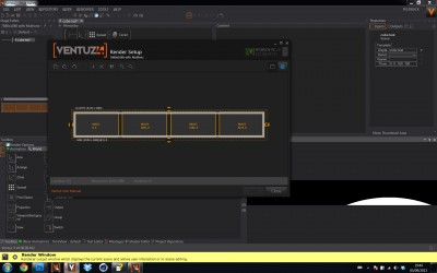

>170 pixels and negative space is not shown, also display zooms.

Maximum Bezel Space Between Monitors?

Maybe its because of my set up: Running this on Windows 7 via Bootcamp on an Apple Macbook Retina display. The resolution of the screen and the graphics card ( GeForce GT650M) is capable of 2880 x 1800 but I'm running it at 1920x1080 as text and images are just too small at full resolution.
Its a fantastic machine for mobile development and Ventuz really flys on it. Have had no problems under Ventuz 3 for the last 6 months.
I noticed that Ventuz was giving me this error if my pixel overlap is larger > 170 pixels.
11:18 06/09/2013 Error : Ventuz Render Setup: Init. of Ventuz Render Setup failed.: E_INVALIDARG: An invalid parameter was passed to the returning function (-2147024809)
It doesn't matter if I have a scene loaded or not. It's the same!

I think I know what the problem is: your computer is not able to create Rendertargets beyond 8192 x 8192.
Your first setup is below this value, the second is above!
Internally we create a full-size 'Design' Rendertarget; render the scene and than copy to the destination 'Production' Rendertarget.
You can verify my assumption with the Rendertarget node.
This limitation could be caused by the Bootcamp virtualization. Modern DX9 graphics boards with sufficient memory natively support 16k x 16k rendertargets.

I should of thought of that! Of course 4 monitors at 1920 plus 3 bezels at 170 comes to the magic number of 8192!!! Over that and the Mac/Windows machine falls over.
My work around when working on my mobile set up is to configure it as 4 lower resolution monitors keeping below 8k pixel space.
