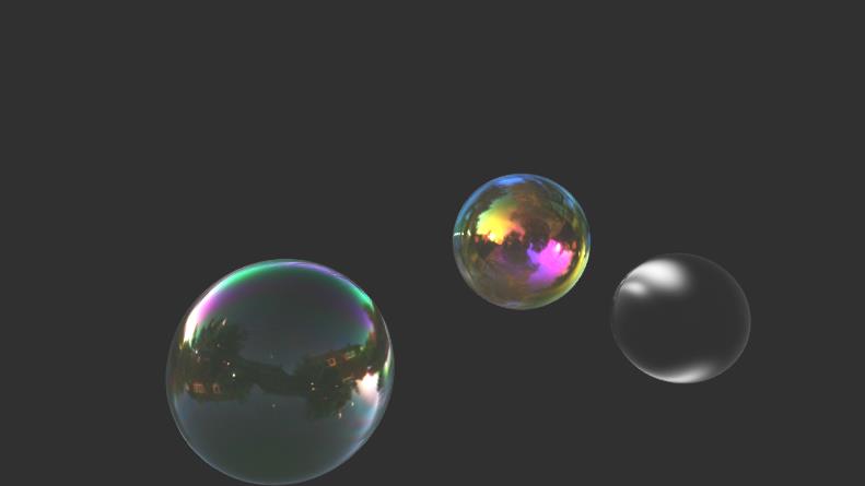

hi ,
there is a need that i need to use bubbles in ventuz scene.
how can i do to make bubble? by importing bubble models or making bubble in ventuz?
when i import bubble models , the effect is bad ,the color and transparent missing,could you tell me the reason.I just import the .obj file and texture the tga file? is there anything wrong?
if in ventuz can make it ,could you tell me how to do ,or you can send me a .vza file to explain it .
thanks , and best regard!

If you only import the TGA you do not have enough Shading on the bubble to look good. You need to add Reflection Maps, Specular Highlights using either Lights or another Texture. And probably adjust the Alpha Blending to get the desired effect. Check the Free Shaders from the Glare Technologies website for some examples on how that works.

hiho,
here a simple demo for bubbles. just a single reflection texture with a sphere.
Bubbles_01_aTom.vza
(697.26 KiB) Downloaded 661 times
