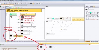

In a official demo project (RoboticSlideManagerDemo), i found a new operation that i can drag a element from the project repository to the hierachy workspace, meanwhile a red wavy border is round the related node.
i do wanna know how to make a relationship between the node and project repository element ? Second question is about the node arrow, red arrow means what ? and how to do like this ? i dont find help in ventuz manual.
I got a snapshot in attachement below.

hi allen
to drag for eg. a hierachy container into the repository you need to hold ctrl while dragging it into the repository. and the red border shows that this object is droped out of the repository

There are different relationships between a container (Hierachy or Content) and a repository item.
If your item is an interface container the reference is shown by a red triangle on the container and if you hover it a tooltip comes up saying somthing like
Because of the reference your items in the scene get a new update function in the property editor.
The second type of reference you can create is a reference based on keywords. If you create a repository item you can set a keyword in the General section. You also can set keywords in your scene by right clicking on the container.
If you now select an element with a set keyword, the keyword or keywords are written in the repository keyword filter(The search field on the top right corner of the repo) and only elements with matching keywords are listed in the repository. If you now drag an element with keyword to your scene all the elements with matching keywords are highlited by a dotted line.
Cheers!
.Referenced item "Cube" of repository "ABC"
Cheers!

I'm sorry i cant follow your reply,for my question in the attachment :
1.I don't find a way how to set the 'Red' arrow in front of a node and the Red arrow means what ?
2.I don't find a way how to set the wavy border which is around the node.
thank u
thank u

I am sorry i did not see your reply : P you give a very clear and powerful answer.Daniel Willer wrote:There are different relationships between a container (Hierachy or Content) and a repository item.
If your item is an interface container the reference is shown by a red triangle on the container and if you hover it a tooltip comes up saying somthing like.Referenced item "Cube" of repository "ABC"
Cheers!
