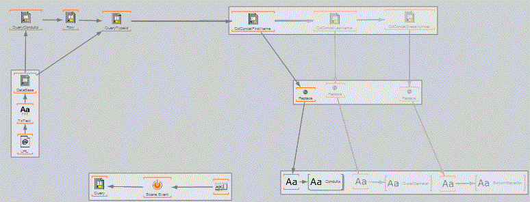

But sorry, NOT ME EXPLAIN WELL, I HAVE MADE MY Query's AS BOTH CONNECTION ISSUE. My database and connects fine, but the problem I have is that I add a keyboard (text field input), I add scene event to start when you type something, with this only add data to the table but not the database. I do not want to add more data, I want to update an existing one in the DB. My query update its correct, run on the same data base. but the connection with Ventuz it´s my problem.
Cheers AHUPA
Cheers AHUPA
Re: database update
This is my connection and query's,
My database table and query displays the information I want, what I need is that information can be modified. I have included a TextField input and the scene of events (start the event with the update query), connect my texfield to replace chain and what it does is add the data, but do not select a specific text and replaces as Ventuz and my database. I don't know how this connection is all I need. I would appreciate your help.

Hmm in the screenshot you attached the outgoing Query node is not connected to a DataBase node in that case there is no connection possible. The other thing I questioned myyself is what the SceneEvent is doing in between the TextfieldInput node.
I guess it triggers the execute command but what is written OnExecute? I can't see a binding from the outgoing string of the TextfieldInput node into the Query.
Cheers!
