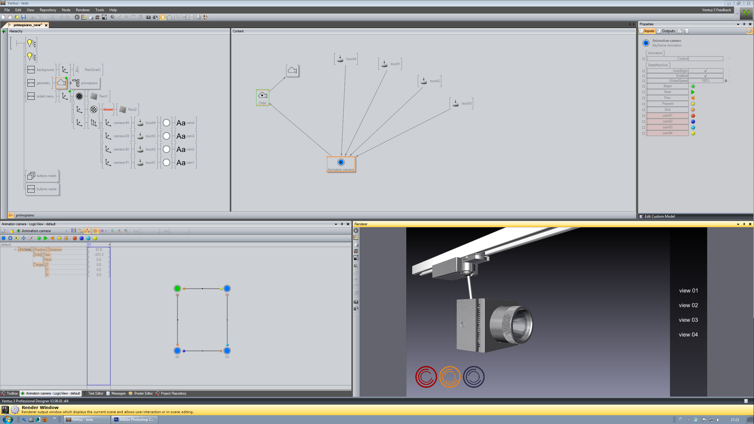

I created 4 states of different camera positions.
I created 4 buttons and 4 custom models
I can go from S1 to S2...S2 to S3...S3 to S4...S4 to S1
How can I create all the possible combinations? From S1 to S4, from S3 to S2, etc?

Just use the AutoConnectStates button in the top left corner of the Animation Editor(The crossed blue arrows).
