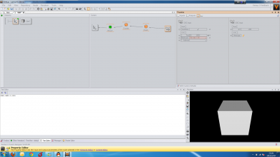

I set up the touch osc as listed below, but I can't control it, who can give a hand, thx.
the properties of the OSC input is in the attachment, and the OSC port and multicast is same with the value of Touch OSC, the value of layout is also set up as "int1", same with the OSC input.

You need to add an OSC Adress to the Ventuz OSC IN node. In your case the Adress should be /int1.

as your instruction, i set the address of osc input node as '/int1", but it still does not work. In my case, the multicastIP address is 192.168.1.101, that is the address of Touch OSC ip address, do I set correctly? furthermore, "If the MulticastIP is set, the node will listen to that address instead of the port on the local machine", does this sentence mean that in case the multicastIP is set, it will be unuseful to set the port address on the local machine?
In addition, the error message said:"7:59 2013/3/21 Error : (OSC Input): Couldn't initialize OSC NetReader for: 192.168.1.101:9000. Most probably the specified port is allocated to another IP address".

OK first of all,
192.XXX.XXX.XX is not a multicast adress it is a singelcast adress. Multicast adresses are in the range 224.0.0.0 through 239.255.255.255.
If you leave the MulticastIP property on the OSC node empty the node listens to the local IP adress and to the specified Port of the machine.
If you are sending your data to a multicast adress you need to add it to the OSC node if you don't use multicast just leave it empty.

Sounds one step forward, but as i press the button of touch osc on ipad, there will be a error message "17:31 2013/3/21 Error : OSC Purge: Error purging messages: Error purging and dispatching OSC messages: Invalid character (\45) / Invalid character (\45)".

I set the port of transmitter with 7000, and the receiver with 7001, no commnunication between ipad and machine. when the port of the transmitter is same with the receive, there will be a error message"15:21 2013/3/22 Error : OSC Purge: Error purging messages: Error purging and dispatching OSC messages: Invalid character (\45) / Invalid character (\45)".
Anything wrong with my setup?

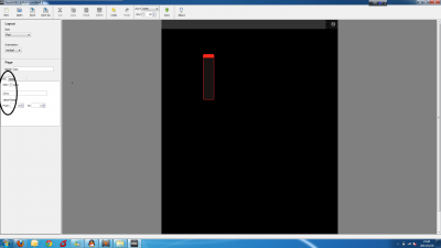

it works!
here is the setup:
the address of touch osc should be the osc in the layout editor, here is the /1/fader1; the Args should be the name in the layout editor, here is the fader1.
