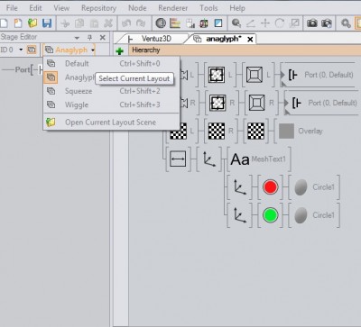

The anaglyph scene is a layout scene so what you need to do is:
Cheers!
The project is seperated in Content scenes and Layout scenes.
- Open the project
- Open the Ventuz3D scene
- Open the StageEditor (View-->StageEditor)
- Select the anaglyph Layout scene
- To edit the layout scene use Open Current Layout scene
Cheers!

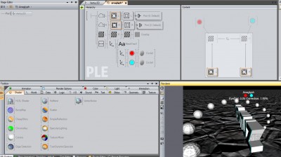

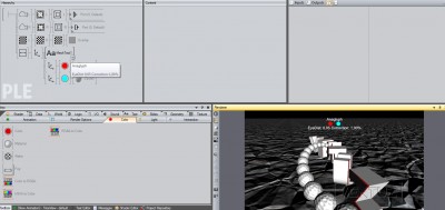

Are you sure you kept the binding between the Color nodes and the Texture nodes that are called R and L?
Marko
Re: Stereo3d anaglyph all grey
Yes - I think so.Daniel Willer wrote:Are you sure you kept the binding between the Color nodes and the Texture nodes that are called R and L?
I made some 3dStereo productions (stills/clips) with c4d.
But here are not the two shilhouettes which such pictures should have. Perhaps a camera problem. Shouldn´t the two cameras pipe into one camera? Or do they pipe in one but I don´t see that? Have to keep on work and learn...

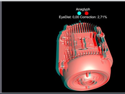

Solved. On bigger machine comparaed to my notebook everything is ok. (see atachement)
Thanks.
Did anybody suceed floating the object in front of screen? Played long with the convergence parameter (correction). No success.
Cheers Marko
