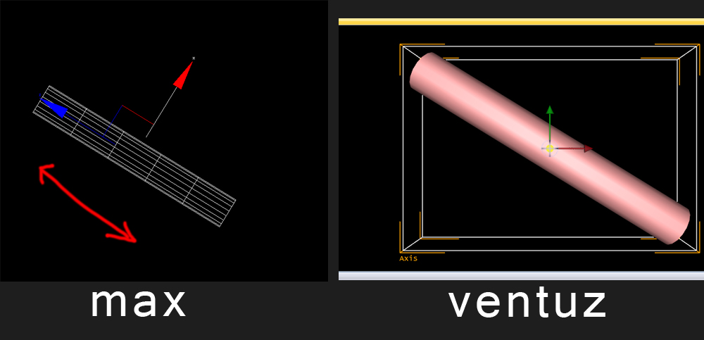

How to achieve moving along an axis using ventuz?
Can the direction of the axis be set inside ventuz?
thanks

Use to Axis nodes and rotate the first one if you use the Position properties of the second one the object is moving along the rotated axis.
