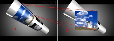

I want to unwrap a wrapped geometry or view port like in the attachment.
Didn´t find something about in the manual (rtfm) or in the entire example scenes.
What´s the way or is there a link to a similar thread or an (unseen) example?!
Regards M.
Wrapped - Unwrapped...as animation
