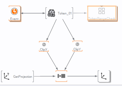

Hi there,
I have a little problem with some mathematical stuff.. :roll: We use the TouchMarker Node and it´s work fine. We get the screen position where the marker is touch the surface. But how the hell can I transform the screen position in world/view coordinates, so I can attache a transform node to the Marker ID pos? I want, that if you move the Marker object on the surface some attached stuff will following the move.
Tia, joschy

hi
i never used touch marker but: is the given position like tuio standart between 0-1? if so, you can use clipping nodes with the input property min=0 max=1 and output min=0 max=screen resolution
greetz
christian

Re: Matrix math - TouchMarker
Post by joschy » 05 Mar 2013, 08:45
Yeah, it seems the way to go. Thought there are similar functions like in unity3d.... ScreenToWorldPoint
greetings, joschy
Post by joschy » 05 Mar 2013, 18:09
strike, got it working :D
