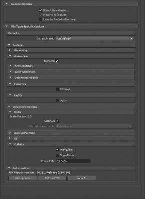

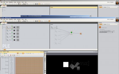

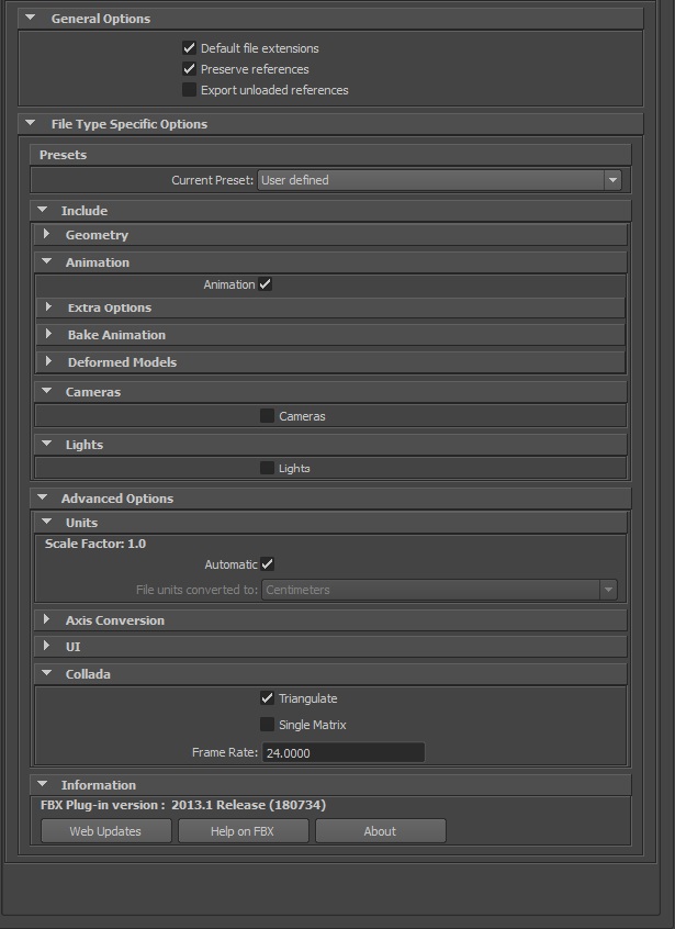

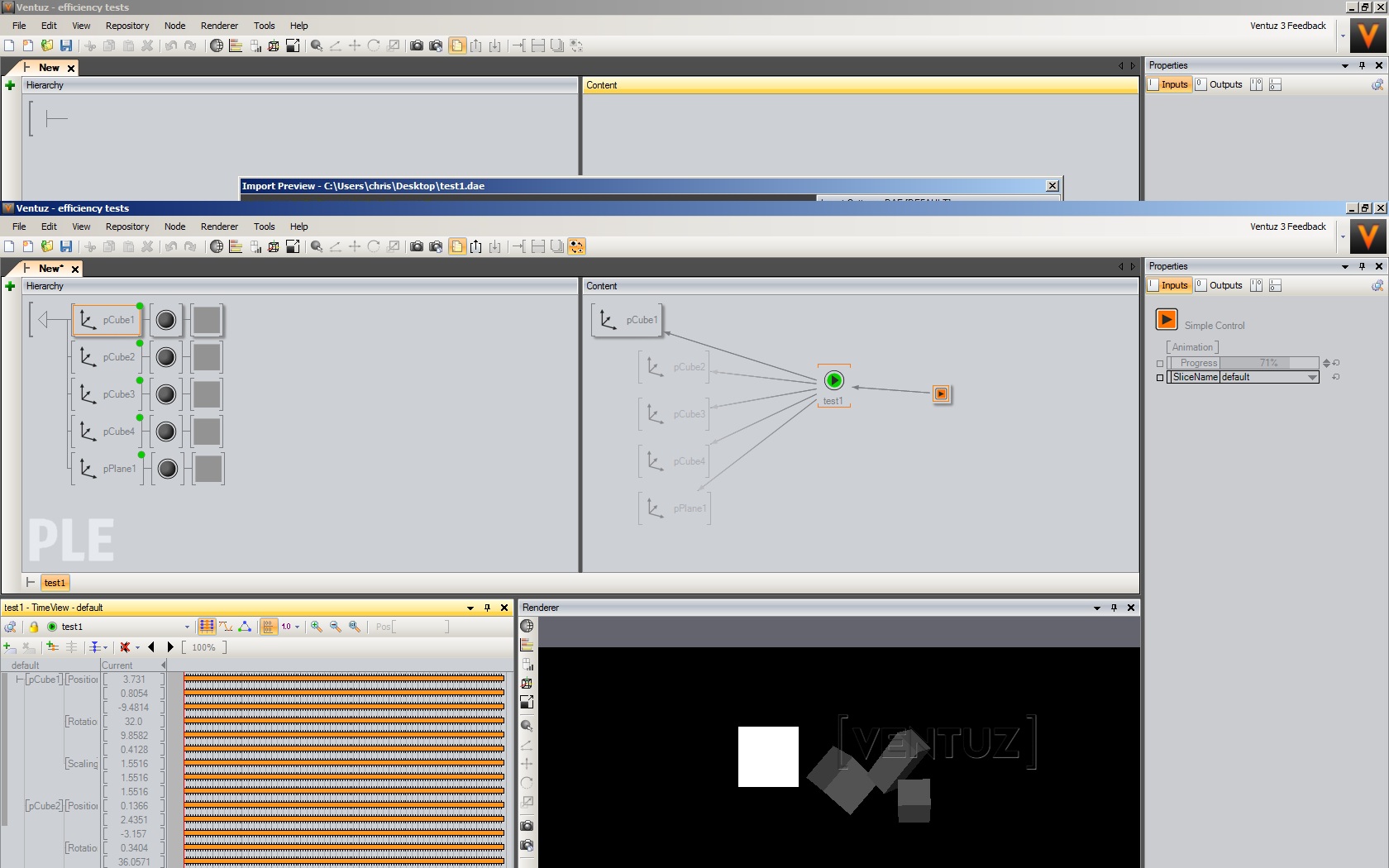

I ran a few tests with your file. Imported into Maya and re-saved it using FBX-DAE exporter in Maya 2013.
Make sure you un-tick single matrix in the FBX-DAE exporter.
Imported fine with all your animation ;)
I've attached some pics with all the steps i used.
Hope it helps fella ;)

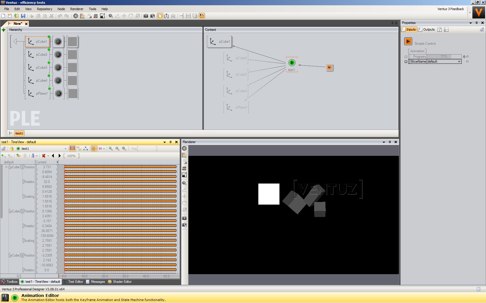

Post by Chris » 12 Feb 2013, 20:47
appologies....same pic twice :)))
