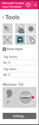

I'm trying to emulate the microsoft surface tag with the microsoft surface input simulator

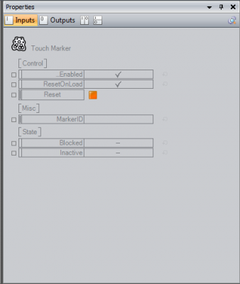

but in ventuz the marker needs ID and in microsoft surface there is just tag series and tag value
So how can I change the tag ID in simulater or in ventuz
