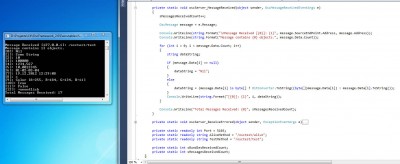

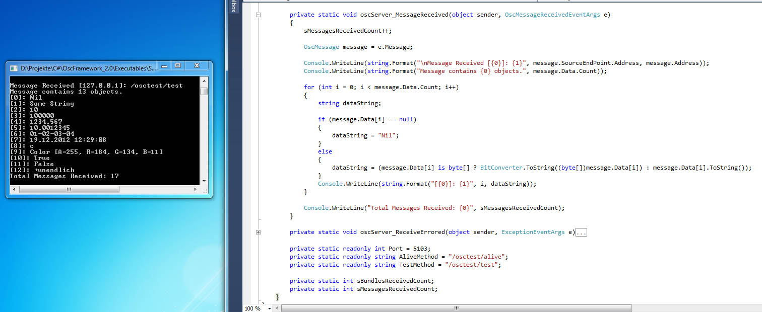

Re: OSC - Syntax help
Me again...
May be I have a error in reasoning. I have to look at the OSC net Framework:
http://www.bespokesoftware.org/wordpress/?page_id=69
There is a sample program with transmitter and receiver, with source code. When I look at the receiver program I understand what is going on and understand the output also, see pic attached.
Is it possible to pick from the message.Data[] list some depositions and catch them with the OSC nodes in Ventuz?
I know the port: 5103
The OSC address: /osctest/test
