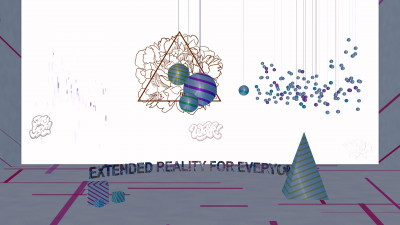

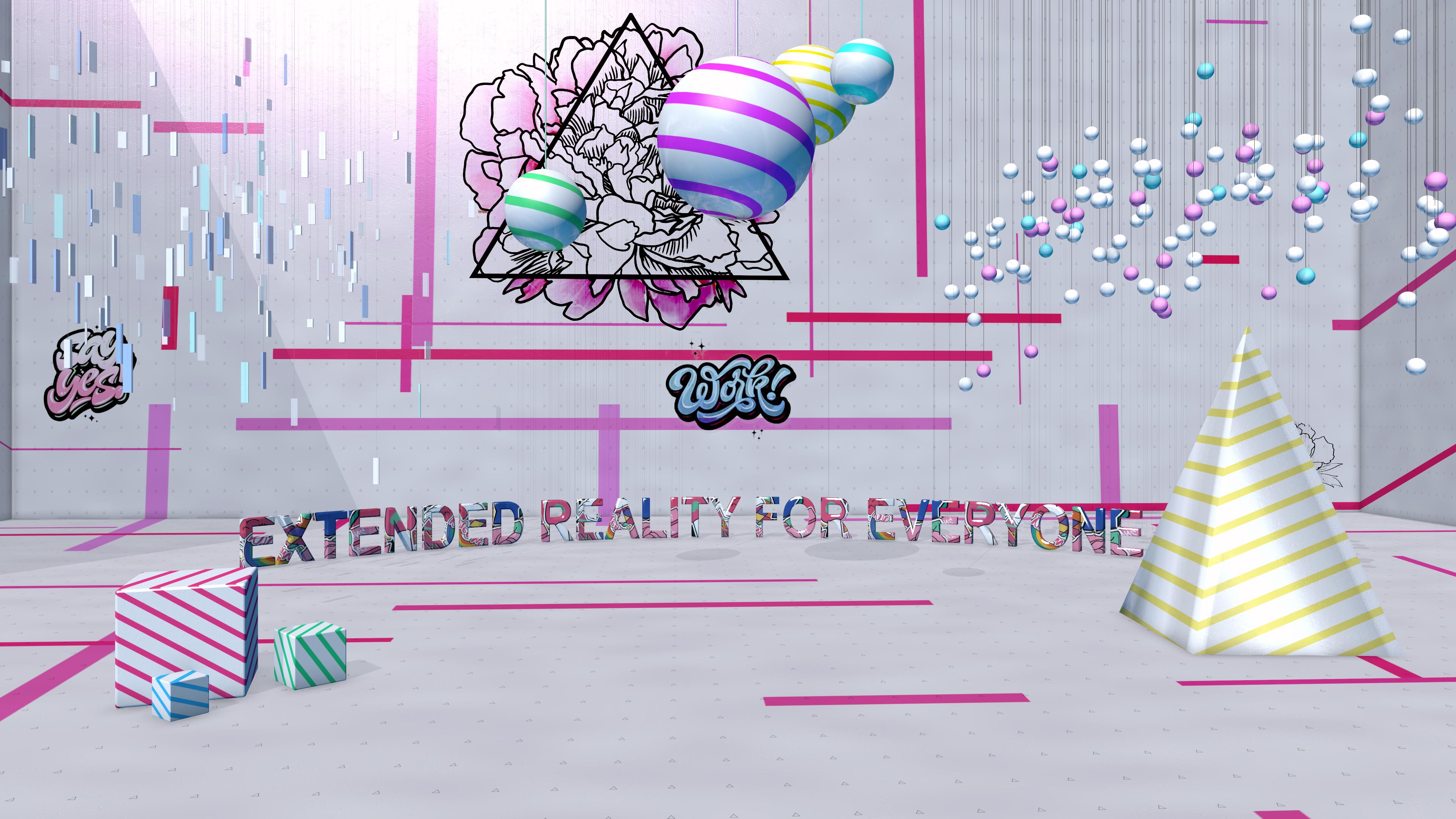

I'm working on a XR config (just for fun at this moment). I imagine you saw the "Mandalorian" technic to have the content of the screen following the tracking of the camera.
For now i code in C# a view and projection doing the stuff quite well => Input : position and size of the screen + camera position => return view matrix + proj matrix.
(If you want this piece of code, I'm ok to share. Just ask)
It's all right until I merged my content scene. My view matrix completely disturb the light calculation it seems.
In the scene of the attached snapshots there's just a skybox (irradiance only) and Directional Light with shadow.
If someone has a hint...
