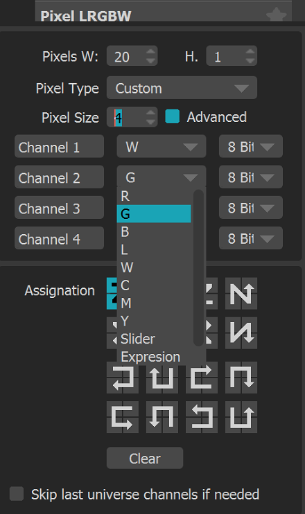

thank you for your anweser. We want to control 20 meters of 144Led/m RGBW Stripe as an Ambientlight behind a videowall.The Artnetnodes support sACN as well, we will check that. Currently we are controlling them with madmapper and controlling the cues with ventuz via osc. We would like to get rid of madmapper.
Thank's for putting things on the list. Concerning the configuration of the 16-Bit-/LED-/Fixture-/Channelconfigstuff I attached a screenshot of the Madmapper Interface, which could be an inspiration
