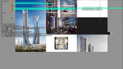

I have enabled all flags for Async and disabled all flags for Auto Update.. this includes 8 texture nodes loading PNG files, a movie clip node, and 1 text file.. all taking from its own directory node also with enabled Async and disabled Auto Update.
Most of the lagg is caused by "TextureResourceGen" which in some cases goes up to 110 ms (attached SS) so I believe that the images is causing this.

Hi Naggar,
the problem is that you do not use the texture that you have loaded with the async Texture Loader but you load the same texture again in the Material node (this time synchronously and stalling)!
You did not bind the Texture property from the 'Aspect Logic' container to the Material node ('Image') but the File Url.
Best Regards
