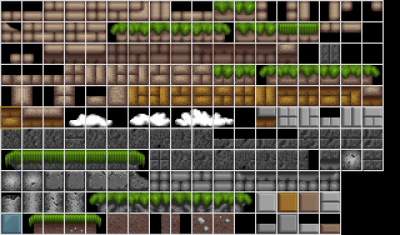

Another way to optimize your project is to create sprite sheet texture out of photos on iPad. It could be done by programmer.
You can use Mapping: 2D StripMapper and run through all of them using one single image. Also, if you can save the sprite texture in *DDS format from iPad on computer it will help in optimization and run app smoother than using *JPG or *PNG.
Kind regards,
Agalar Ragimov
- Example of the sprite texture in the game industry

Well i managed to convince the client to use 300 images at a time. Life saved.
But will still try to use Sprite mapping and see how it works.
