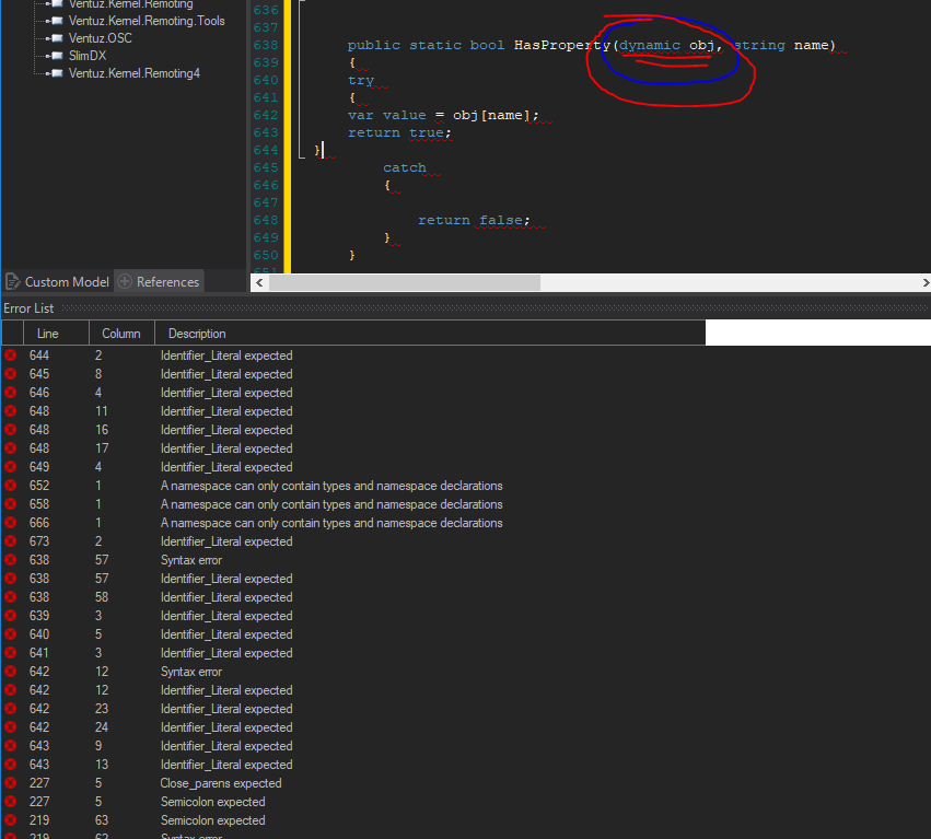

Re: Ventuz 5.4.0 Released
I am facing bunch of errors in C# node that was working well on previous version.
Now, compiler doesn't understand word *dynamic* in code.
Any suggestions?
Any suggestions?
Hello!
Having same issue as above in C# nodes. "dynamic" keyword is not working.
While in release notes it states "C# Script Editor is now able to parse latest syntax features like 'async'. C# and VB compiler are now on version 4.0.", the C# looks like its been downgraded.
Please fix it in next version. Cause as for now we have to rewrite many of our code nodes because of this issue.
