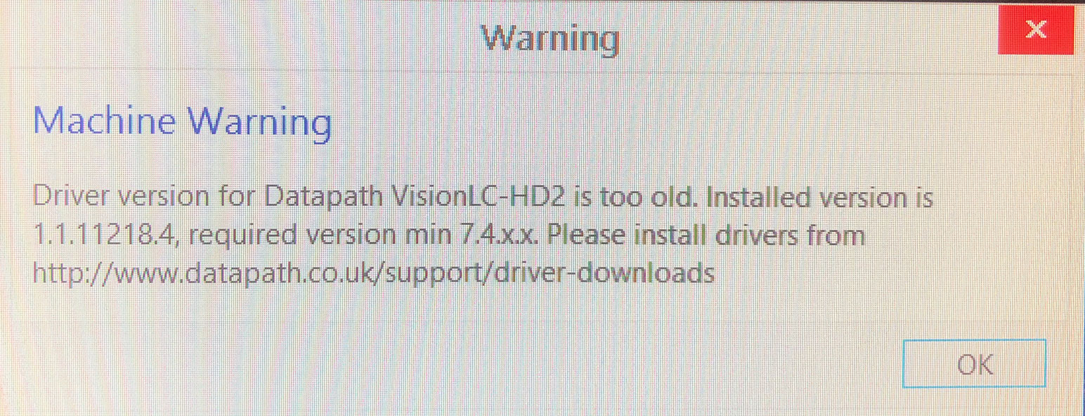

Anyone successfully used the Datapath Vision LC capture cards (LC-HD2 or LC-SDI) with Ventuz?

Have you tried the "Vision" drivers instead of the "VisionLC"?

From the manual : "Ventuz supports the Vision-AV and Vision-SC series, including the VisionSC-HD4+ board. "
Vision LC is new, and not yet supported. I am pretty sure we will add support for this, but no schedule has been made yet.

Yes, in our test system we have these SC cards as well.
It's already several weeks ago that I tested the LC card for the first time and what i can remember is that when I replaced the card with the LC Card it first worked (probably with the SC drivers) I then installed the LC drivers and it was not working anymore.
Tried to uninstall the LC drivers, reinstall the SC drivers, etc, but without any success.
According the manual, Ventuz does not support the LC range of cards.
