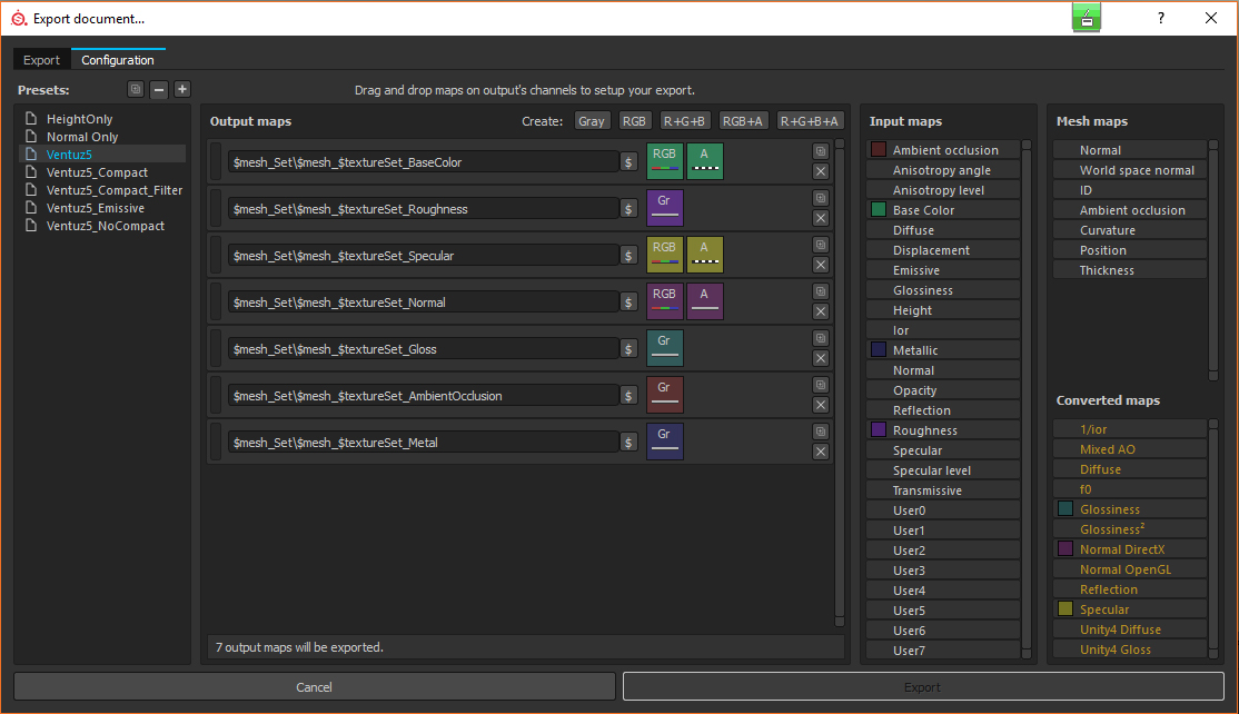

Ventuz5:
This is the basic Export Preset for Ventuz5. It will simply create all available maps, a single texture for each channel. This can be used in combination with the "TextureSet" import with V5.
You can combine and compact them on your own and also modify them easy.
Sidenote: You can export to any kind of supported format.. tga.. png... jpg and so on.

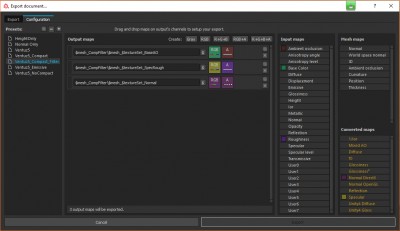

Ventuz5_Compact_Filter:
This is a special set, basically its the same as the "Ventuz5_Compact" but has and can be used with a "baking light filter" .. watch this:

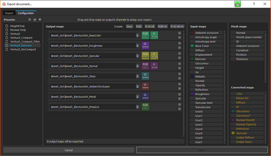

Ventuz5_emissive:
This preset exports single maps, including the emissive channel.

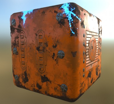

And to check and test everything i send you my beloved "DemoCube" :P
You can Download the SubstancePainter Presets here:
Substance Painter Presets
You can Download the DemoCube for SP 2.4.1 (110mb) here:
DemoCube
I hope you enjoy the Presets and the DemoCube. The Material on the DemoCube is a standard "shipped with SubstancePainter" Material, which is just altered in the color.
