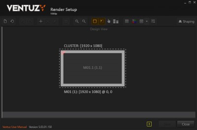

Christian Krix Schmidt
- Posts: 290
- Joined: 18 Jan 2012, 11:36
Re: How to set pixel dimensions of snapshot to disk/clipboar
Yes that's odd. If I want screenshots in Designer at 1080p exactly, regardless of my Render Window size I simply create a RenderSetup as seen in the attachment and then activate that in the Stage Editor. But I usually also have the Project Settings in the same resolution so the aspect ratio matches. Just in case. Maybe it is a combination of hardware and software. amd and nVIdia and even Intel chips do behave a bit different, especially on different Operating Systems, as I just found out recently. I am running Windows 10 and nVidia Geforce/Quadro. What are you using?
