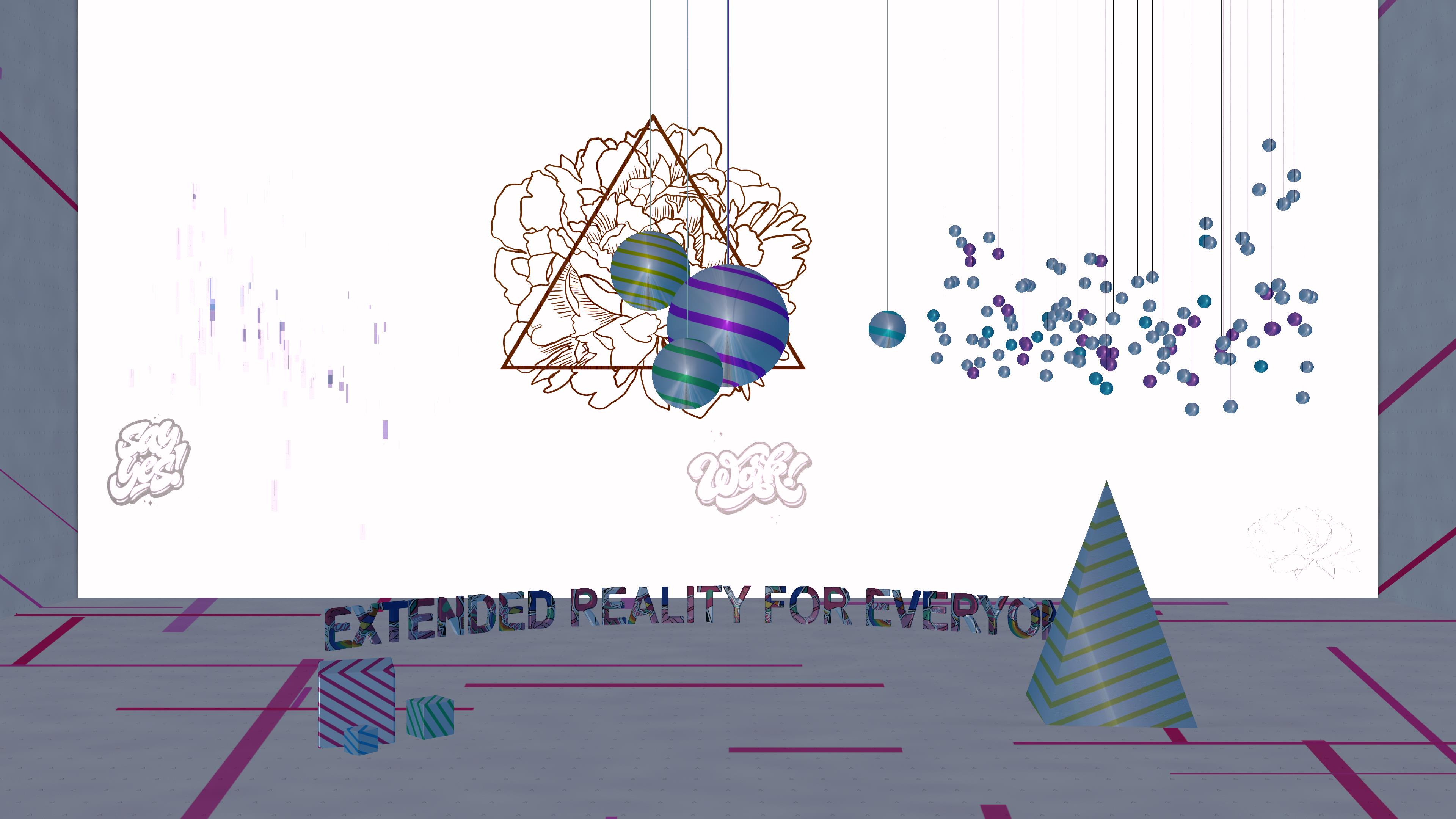

I'm working on a XR config (just for fun at this moment). I imagine you saw the "Mandalorian" technic to have the content of the screen following the tracking of the camera.
For now i code in C# a view and projection doing the stuff quite well => Input : position and size of the screen + camera position => return view matrix + proj matrix.
(If you want this piece of code, I'm ok to share. Just ask)
It's all right until I merged my content scene. My view matrix completely disturb the light calculation it seems.
In the scene of the attached snapshots there's just a skybox (irradiance only) and Directional Light with shadow.
If someone has a hint...

Yes exactly and more precisely the view matrix. If you change the scipted view matrix by a simple "look at" while keeping the scripted projection matrix, the rendering is ok.
This is more a 3D matrix problem than a scripting problem I think. And how the view matrix intervene in lighting, irradiance, texturing, SSAO...
So, does anyone know if there is another way to have this "window effect" without the view matrix / light calculation problem ?
