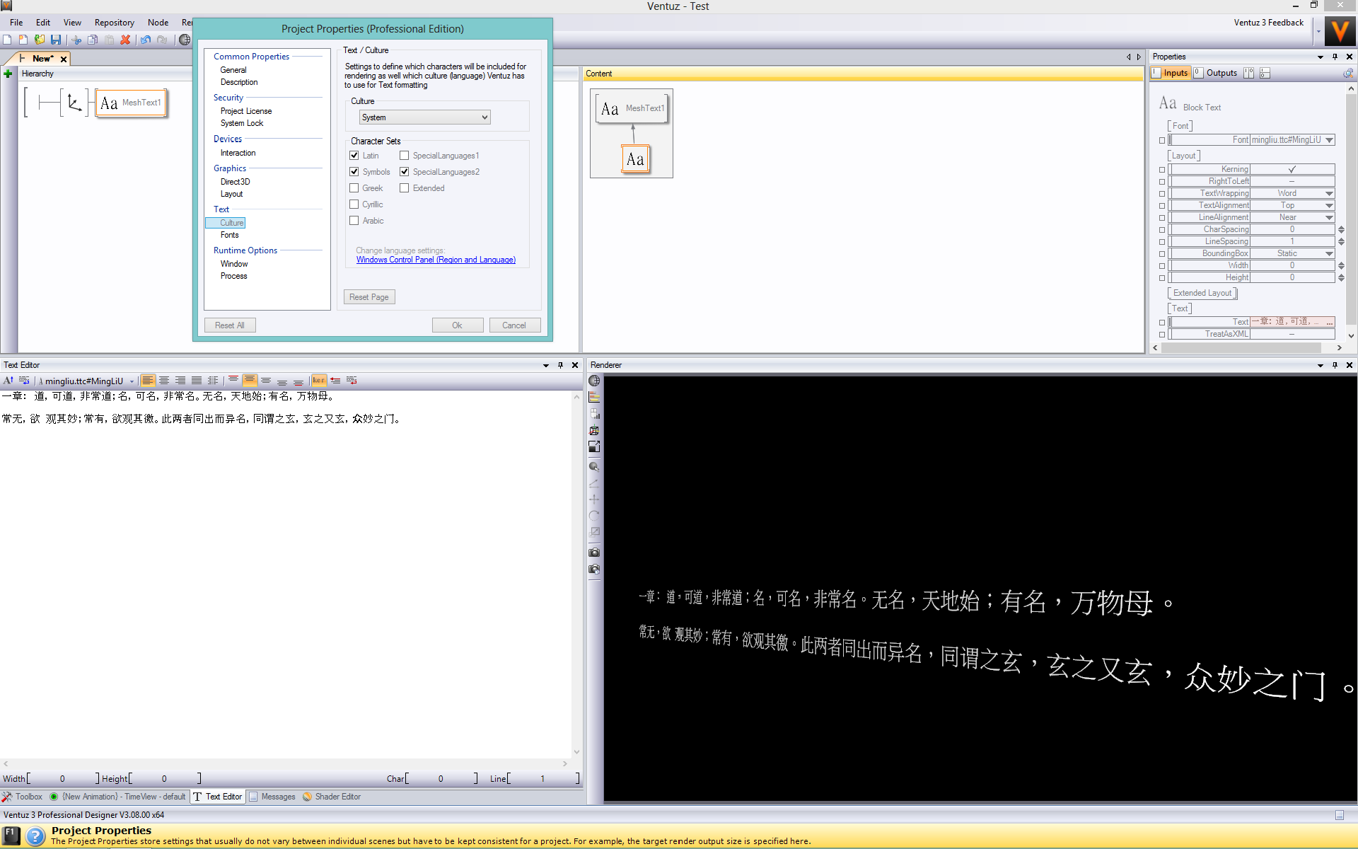

Re: Do the Ventuz support chinese ?
Make sure the font you have chose actually has the Asian character tables! The Ventuz default, Arial, for example, does not. Thus, you need to select a font manually. I have attached a screenshot of all the parameters you need to set up. There is nothing else to do. Remember that with the asian character sets, it will take a few seconds on loading the project to set up the whole typeset.
