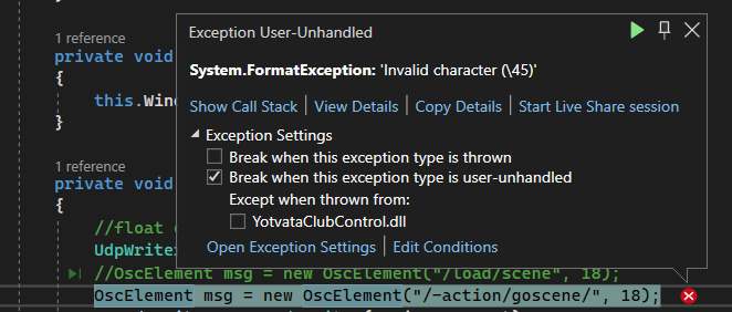

I'm trying to send an OSC commant to Behringer X32 console.
The command is :
OscElement msg = new OscElement("/-action/goscene/", 18);
I'm getting an invalid character error about the DASH (-) character.
How do i solve this?
Thanks

Hi jozee,
this seems to be a bug on our side and this restriction does not match the OSC spec.
Thank you for the feedback
Re: Invalid characters in OSC
Fixed for V6.12.1 released yesterday.
