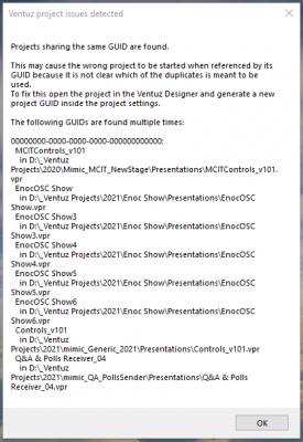

I keep having this issue whenever I try to scan my projects through the task bar I get a popup saying "Projects sharing the same GUID are found". I tried solving it by "generate new GUID" but it feels like this does nothing, and I keep getting the same issue.. I have also tried it with different machines using different Ventuz Licenses. Note, this also happens sometimes when I have VPRs in different Projects.

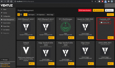

I'm not sure if this is related, but I think it also leads to another issue i get when trying to run a project through the browser configuration. As you see below, there is a broken icon in the VPR file (Controls_v101.vpr). Nothing happens when I try to run this app by clicking start. but I can still run it via ventuz configuration editor in the machine with no noted issues. thanks

Just do it as the ERROR says: Open the scene/Project in the Designer and generate a new GUIID.
They have all the same ID, how should Ventuz know what to start? Shall Ventuz start ALL projects?
Never have the same project name twice in a search path
Never reuse the same GUIID for several Projects in the search path........

as mentioned above, I've already tried that. it doesn't work.
Plus even if I didn't do it.. there's no way i should have 000000-000-- etc as a GUID correct?
Also, having multiple VPRs in the same project folder is not allowed anymore? shouldn't the VPRs generate new GUID as they are being exported?

It's true that copying a ventuz project file will also copy the GUID, which might lead to that problem. However, when creating new projects or VPRs Ventuz will ask the OS for a GUID which should never occur twice. That's what the name stands for - globally unique identifier. It's not up to the user to take care of those GUIDs. Again, only copying a VZP should generate the problem.
All 0s is not a valid GUID, so there is defenitely something wrong there!
Oh, using the same Project name more than once should also be ok. Ventuz uses GUIDs to distinguish projects and/or VPRs.

- unanswered question: could this be related to the broken Icon I get in the browser configuration editor (which cannot be started)?
