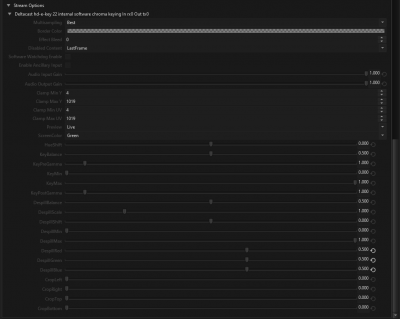

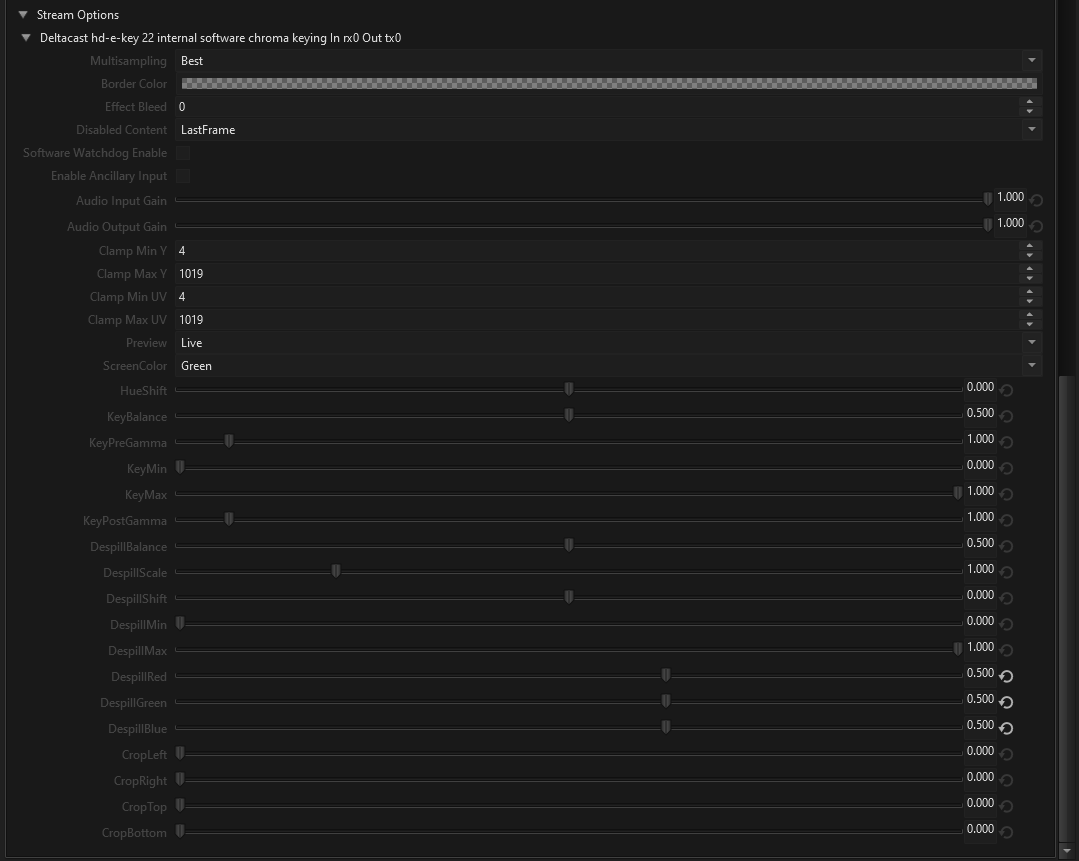

if you switch the output for an SDI board to internal software keying, you will have the Color Difference Keyer options available in the live options:
there you can make adjustments then and save the configuration.
