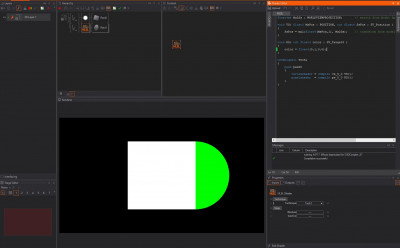

I think that we have a problem with alpha in HLSL shader.

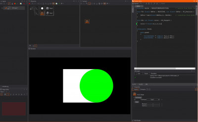

The green circle should be totaly transparent in the second case. Look at the attached pictures and the shader code.
We would appreciate a quick fix if it's a real bug.

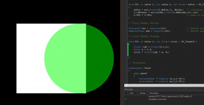

The output is pre-multiplied. Apply your alpha to RGB before outputting it (multiply RGB * A)
Re: Shader issue with alpha
Ok man you are my master
Thank you lerou !
