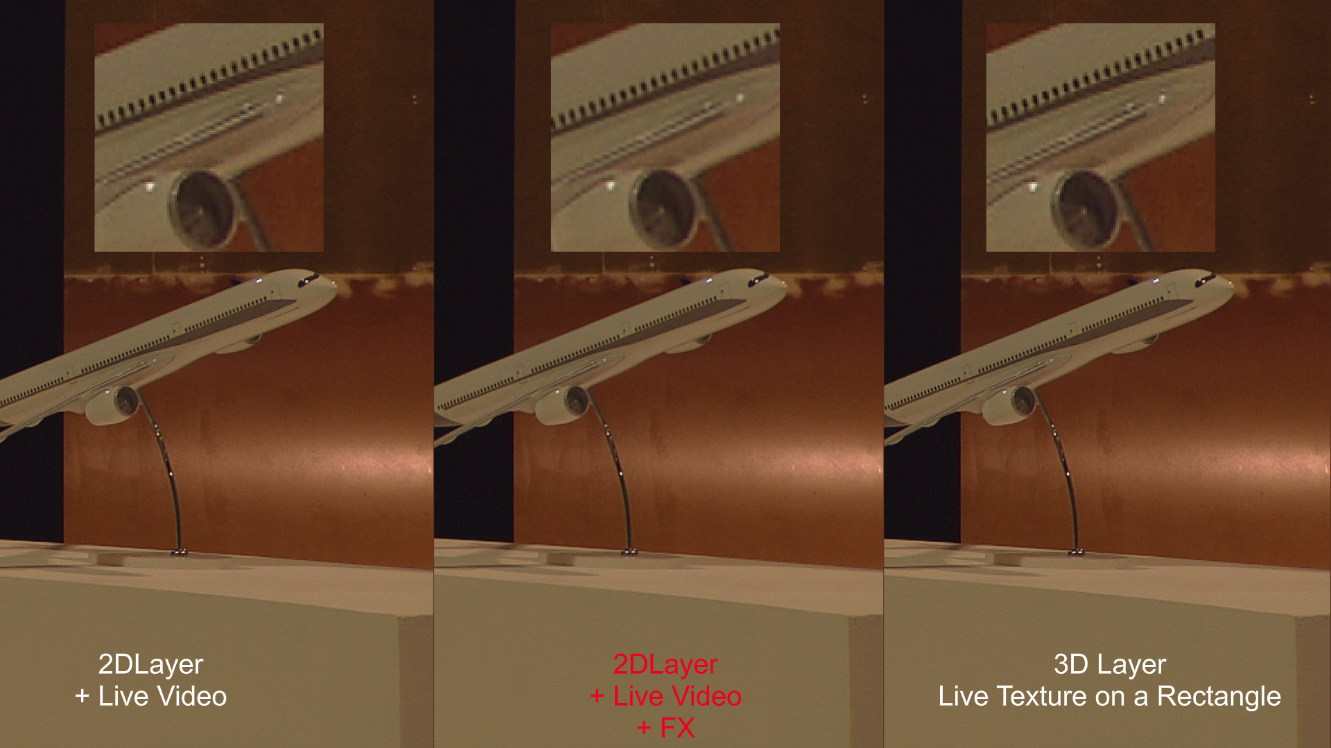

My explaination wasn't miss somme details.
As soon as we add an FX in a 2D Layer + Live Video I noticed this up and down effect in the picture that made the reolution looking divided by two.
See pictures attached. These pictures are rendered in Ventuz and are consecutives.
R

Re: HD SDI 2D layer issue
As you can see in this gif file (click on the picture to see the gif animation)
The picture of the middle is moving up and down initialy at 50fps.
The gif show 3 situations and I added a zoomed part of the picture on top of each situation:
1. on the left, correct deinterlacing within a 2D Layer Live Video
2. on the middle we added to the 2D Layer Live Video an Effect. The deinterlacing is going up and down. This is the bug.
3. on the right we used a 3D Layer with a live Texture and it is correct.
What I forgot to show is that when we add an Effect node in the 3D Layer the deinterlacing still correct.
Could you have a look please?
Thx
R
