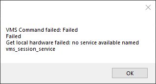

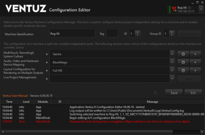

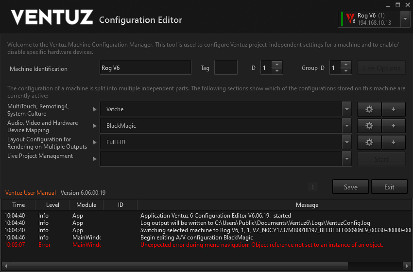

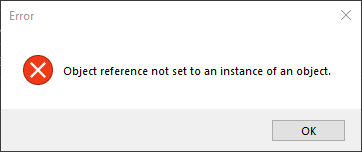

Hi again, tried everything and nothing works for me. Can't get to open ventuz settings getting same error...
The problem is that Blackmagic is working with adobe premiere & Unreal ! only Ventuz has problems...
My blackmagic card is 4k extreme 6G, inside thunderbolt case, and connected via usb type c to my laptop.

Post by serourian » 22 May 2020, 09:02
I think the problem is that VMS is not finding the device on the thunderbolt.....
Are you able to do a test over a thunderbolt ????

Post by serourian » 27 May 2020, 10:10

2020-05-13 13:10:29.9 [Info ]: (App|) Exiting application
2020-05-13 13:16:25.8 [Info ]: (App|) Application Ventuz 6 Configuration Editor V6.05.91. started
2020-05-13 13:16:25.8 [Info ]: (App|) Log output will be written to C:\Users\Public\Documents\Ventuz6\Logs\VentuzConfig.log
2020-05-13 13:16:26.9 [Info ]: (App|) Switching selected machine to Machine 113, 1, 0, VZ_N0CY1737MB0018197_BFEBFBFF000906E9_00330-80000-00000-AA547, 194.168.10.13
2020-05-13 13:16:30.0 [Info ]: (MainWindow|) Begin editing A/V configuration BlackMagic
2020-05-13 13:16:37.1 [Error ]: (MainWindow|) Unexpected error during menu navigation: Object reference not set to an instance of an object.
<Exception Type="System.NullReferenceException">
<StackTrace> at EditConfig.App.ConfigEnvironment.AVConfigEnvironment.BeginEdit()
at EditConfig.MainWindow.OnNavigateTo(Object sender, NavigateToEventArgs e)</StackTrace>
<ToString>System.NullReferenceException: Object reference not set to an instance of an object.
at EditConfig.MainWindow.OnNavigateTo(Object sender, NavigateToEventArgs e)</ToString>
</Exception>
