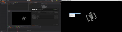

Is there anything special to be done to get the NDI Output(s) to work? All I did so far was adding NDI-output(s) in the Configuration-editor. Hoping Ventuz would show up as a source for NDI-receiving devices. It doesnt.

Here it is working with the latest 6.3.(4.378).
Simple NDI outputs (no NVidia or AMD) in config.. Fired up Designer, used a simple cube scene, opened up NewTek Monitor (which comes with the NDI Tools from new tek) and i can see the "local stream"...
Even if i use any machine in my House, i can see the stream... Even if i use all my Smart-TV's.. i can see the stream..
Check your errorlogs? Maybe there is a hint why it is not working...
RegArts
i cant tell you whats wrong on your side..
RegArts

Anyway, I somehow got it to work. Must have been a firewall setting. I get one output only, not aalphachannel.
And the NDI-Inputs do not work reliably anymore... hm..
