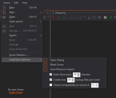

I recommend that you enable Scene Backups in Designer. So that you have the chance to go back some revisions in case that something like this happens again.

Here is where you can find the settings:

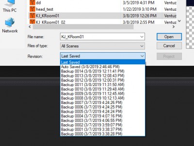

Here how a dropdown selection for backups looks like:
