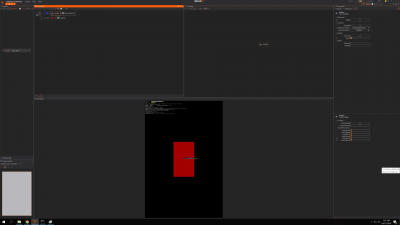

Re: Geometry above a Button
Hi Karol,
Attached a screenshot. So the blue rectangle is behind the red. The red rectangle does not have a touch button before it. But when i hover my mouse on the red, the touch inside is occluded on the blue rectangle.
Is this normal? how do i overcome this situation?
Thanks
Nik
Thanks
Nik
