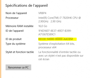

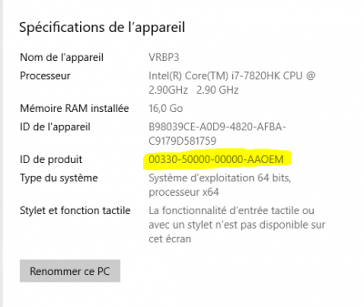

is the SystemID generated by Ventuz based on Product's ID from WINDOWS 10 system Information?
if so , you have to generated this SystemID from machine's ID from WINDOWS 10 system Information;
because if you buy severals machines of the same type, they have the same product's ID.
and you willl get the same SystemID Error in the Ventuz configuration editor.
I already try to change manualy the registry Key with a SystemID like you say.
It is not working ? i get the same message in the Ventuz configuation editor.
What can I do ?
Regards
Mat.
Error: Two Machines with the same SystemID
